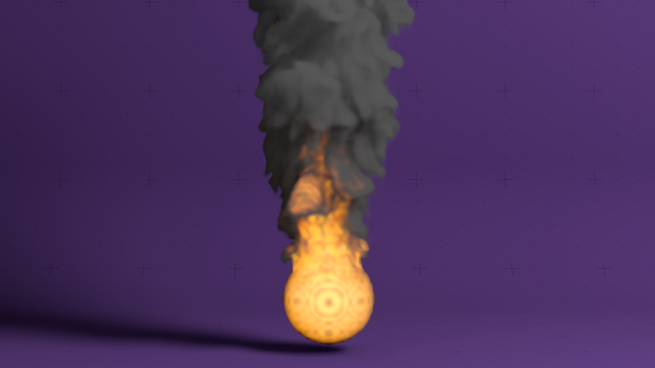

A 3D field material suitable for pyro / explosions.
A 3D field material suitable for pyro / explosions. The field density is used to control absorption and scattering, and the temperature of the field is used via black body simulation to output an emissive colour. The Scattering parameter is used to control the ratio of scattering vs absorption.
