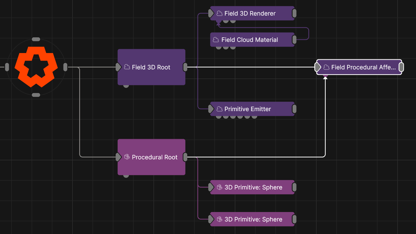

This node affects a field's velocities by attracting or repelling it using a procedural's surface.
This node affects a field’s velocities by attracting or repelling it using a procedural’s surface. The affector may apply as a force, which injects it into the simulation; or as a velocity modifier, which injects it each frame post-simulation without feeding into the simulation itself.
Direction The direction of effect.
  • Attract : The field is attracted towards the procedural surface.
  • Repel : The field is repelled away from the procedural surface.
Velocity Scale The scale of the applied velocity.
Procedural RootInput a procedural for the field to collide with.Procedural Root
