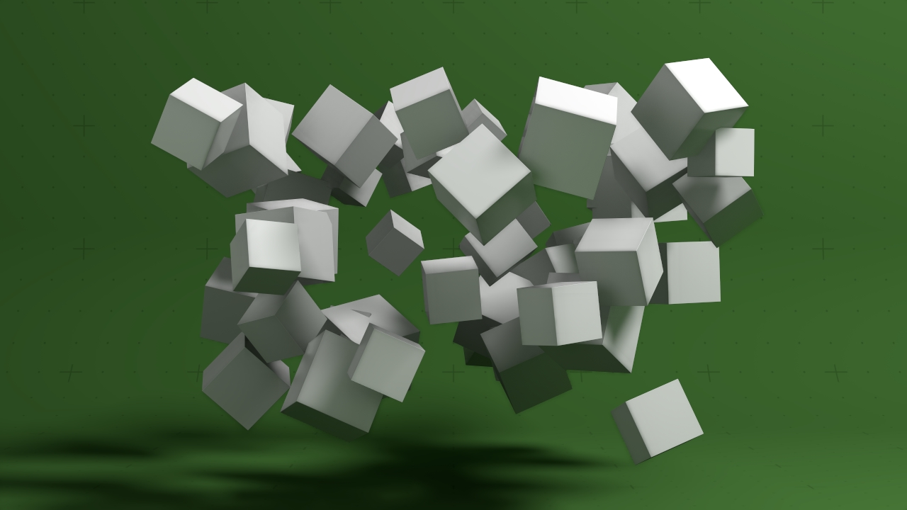

Generates clones with random transformations.

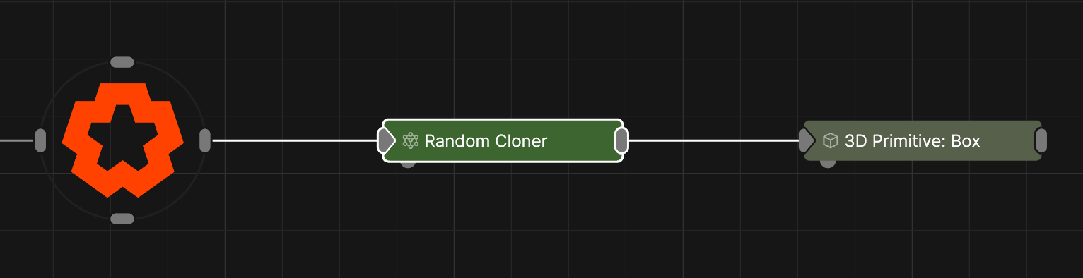

This node generates clones with random transformations within a specified area.
Scale Randomness Adds randomness to the scale of each clone.
Spread X How much the clone positions are spread across X axis.
Spread Y How much the clone positions are spread across Y axis.
Spread Z How much the clone positions are spread across Z axis.
Spread Heading How much the clone rotations vary around the X axis.
Spread Pitch How much the clone rotations vary around the Y axis.
Spread Bank How much the clone rotations vary around the Z axis.
Rotate Clones Allow the cloner to rotate clones at generation.
Scale Clones Allow the cloner to scale clones at generation.
Seed Select a random seed for the cloner generation.
EffectorControl how the clones behave once spawned. See Effectors.Plain Effector
