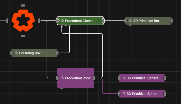

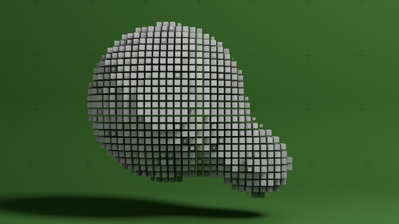

Generates clones from a procedural system input.
This node generates clones based on a voxel representation of a procedural system. A voxel volume is defined by the bounding box, which then samples the procedural system to find whether the voxel is inside or outside the distance field. Voxels inside will then generate a clone, voxels outside will scale based on the distance threshold to 0, where they are de-spawned.

Rotate Clones By Normals Rotate clones to match the normals of the volume.
Scale Clones By Voxel Size Scales the cloned objects to match the voxel sizes.
Distance Threshold Outer threshold for the distance field.
Min Distance Threshold Inner threshold for the distance field.
Distance To Clone Size Scale Scale the clones based on distance from the center.

Procedural RootSource Procedural System to generate clones from. A Procedural Root must be connected for the cloner to generate clones.Procedural Root
