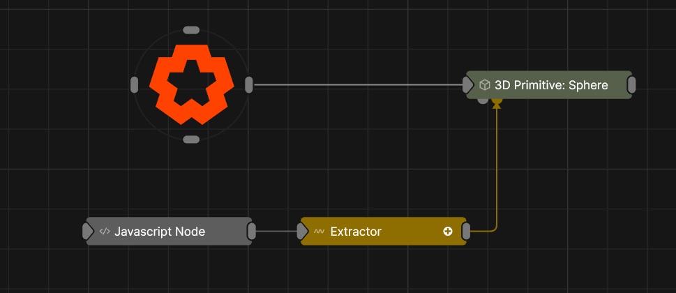

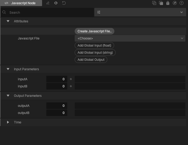

In the JavaScript node you can hook input and output global variables for use within your scripts Update() function. Prior to your script being run, Notch will read the inputs from the nodegraph and set the global variables in JavaScript. You can then use these global variables and write out to a set output global variables. These output global variables are then pushed into the JavaScript node and can be read using the Extractor Node.
Javascript node variables can be renamed and removed by clicking on teh chevron/downwards arrow that appears when mousing over the property in the property editor.
Full Example #
javascript-nodegraph
javascript-attributes
var inputA, inputB, outputA;
function Update()
    outputA = inputA + inputB;
