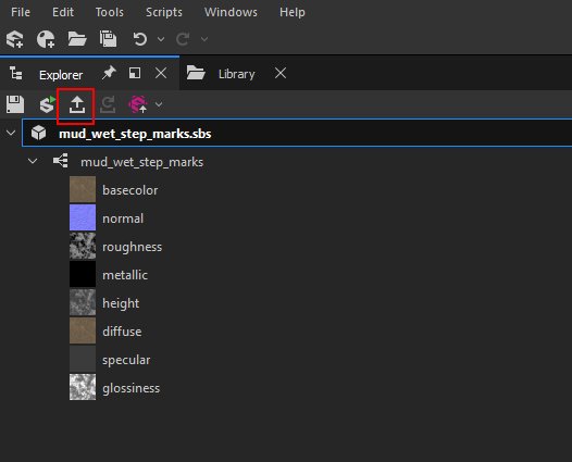

Exporting .sbsar Materials from Substance Designer #

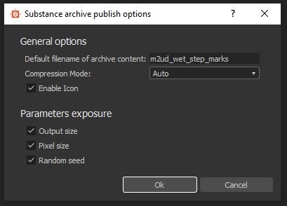

To export a material, click on the icon with the arrow. “Publish selected Element(s)”
material-substance-exporta
Leave the default settings, click OK. Your substance material is now exported. The extension for substance designer file is .sbsar

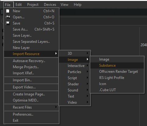

Importing .sbsar materials into Notch #
There are two ways to import a.sbasar file into notch : You can drop your file in the Resource panel. Or using the menu : File/Import Resource / Image /Substance material-substance-importa material-susbtance-icon

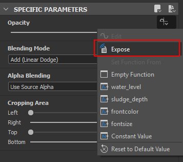

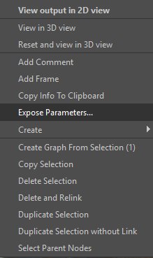

Creating exposed parameters in Substance Designer #
To modify a texture directly in Notch it is necessary to expose the parameters you want to modify. You can expose any parameter, colour, value, text, etc
In Substance Designer, right click on the selected node and “Expose parameters” :
material-substance-exposeb

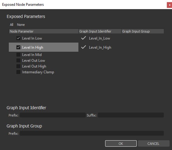

Choose which parameter you want to expose :
material-substance-exposec
You can also click on this icon of the selected node :
material-substance-exposed

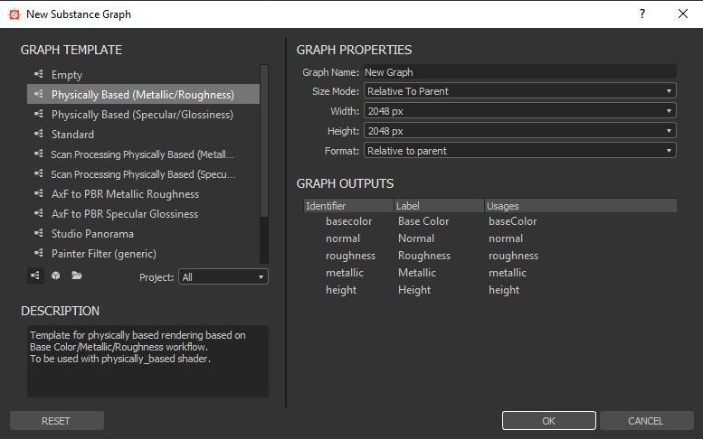

Creating materials in Substance Designer for Notch #
When you start a new Substance Designer material use this template :

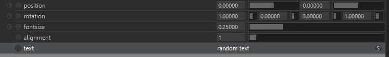

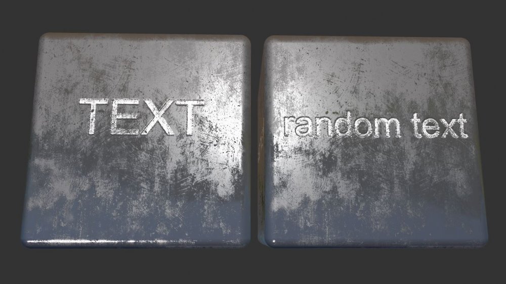

Substance Material Exposed Text #
You have the possibility to use text in your textures with substance designer. By exposing the text you can modify it in Notch.
Same material with different text
Text option in material

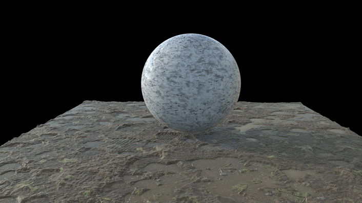

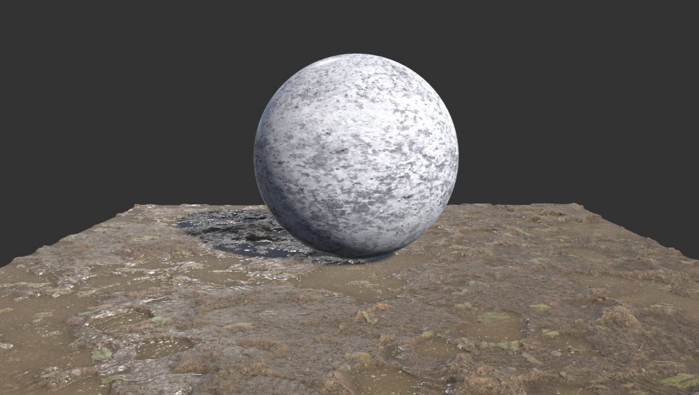

Substance Material and Height map. #
A lot of Substance Designer materials utilise a height map. A height map deforms the mesh by changing the position of the vertices. When using a heightmap material in Notch, it is necessary to modify the “Displacement” value. It is also important that the object has enough faces (appropriate use of Subdivisions and Tessellation is advised)
Height map on high poly mesh vs low poly mesh
